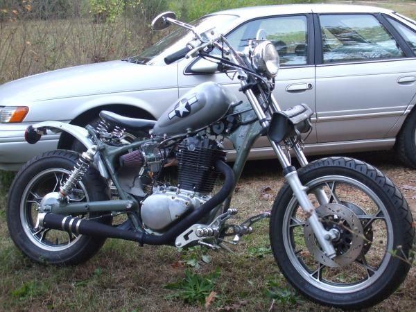

'96 Savage
GS650 forks, brakes, wheels
tank,seat and fenders from other sources
engine: bored from 650 to 700
forged piston 10.5:1 cr & heat treated
cylinder bored to 97mm with silicone carbide treatment
camshaft reground by Webcam... OH YEA !
Barnett hvy duty clutch pack & springs
38mm Edelbrock Quicksilver carburetor
head ported; especially on exhaust side
custome header with special R&D muffler by Revolution Air
intrumentation: Veypor
belt drive replaced by #530 chain/sprocket
Performance ? ? ?
stock was 25-27hp at the rear wheel
now ? ? est. 55-60hp at the rear wheel when it goes to the dyno (need to work out an electrical shourt in the wiring somewhere)
