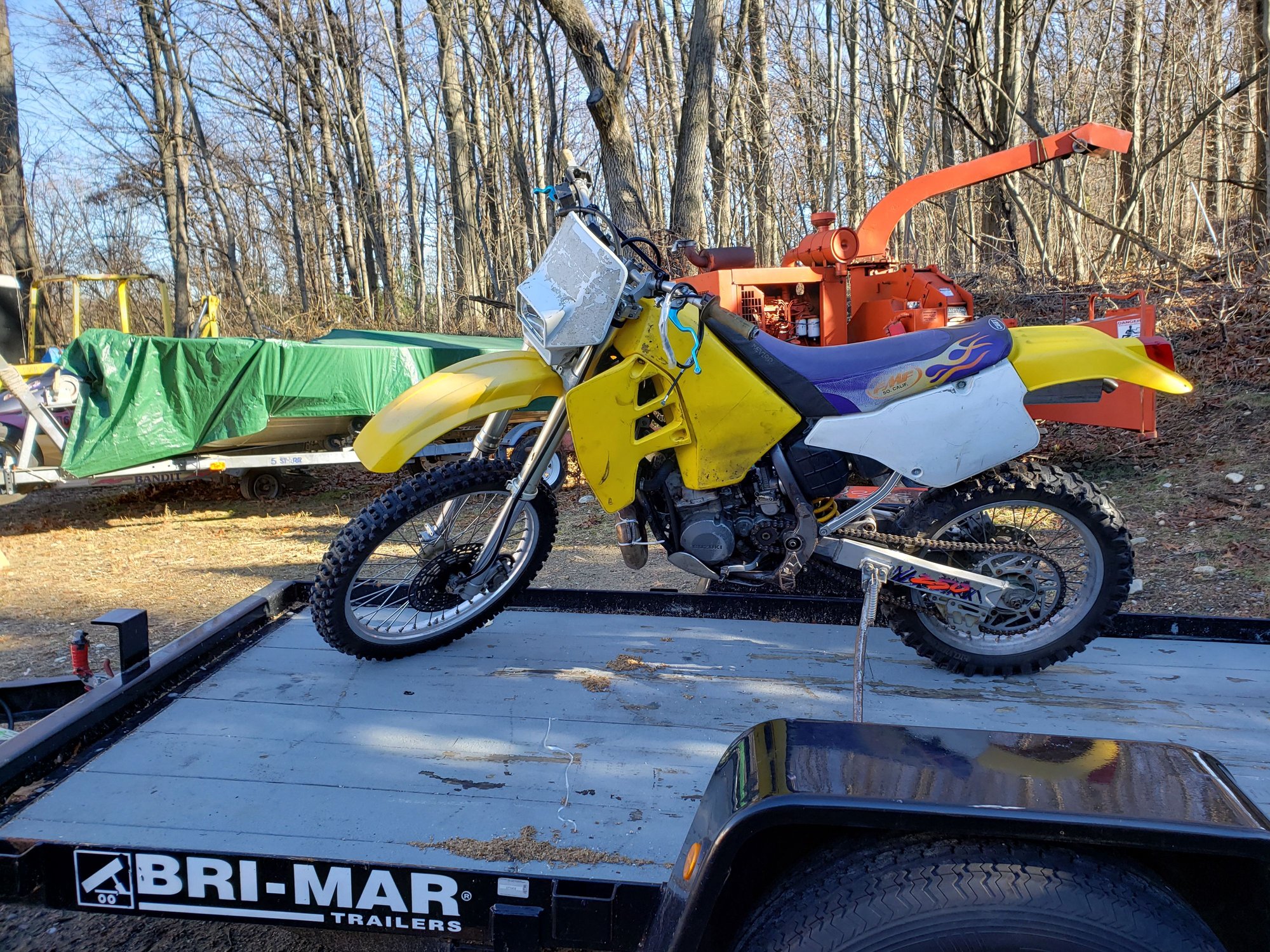

Good luck with your build. I'm just about done with my RMX restoration. Check out how fugly mine used to be compared to now!
The day I bought it for $300
As it sits today just about done, aside from the top end and a few other odds and ends. Just waiting to get the cylinder back from being re-plated at millenium technologies
